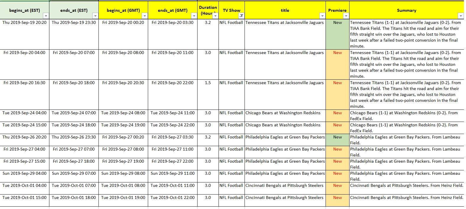

Thanks. I can see the issue regarding the “New” indicator. The times you have given me have gone now so can’t go back and check - but i can see the issue in future airings. Those shaded in orange appear to be wrong

So for these examples, I need to establish if the “Tennessee Titans at Jacksonville Jaguars” game records Thursday 19 September at 20:20 EST and again Fri 2019-Sep-20 at 04:00 EST and 16:30 EST
