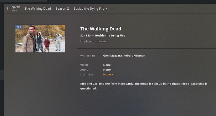

Your logs show a failure to retrieve.
I created it now and obtained an instant match.
