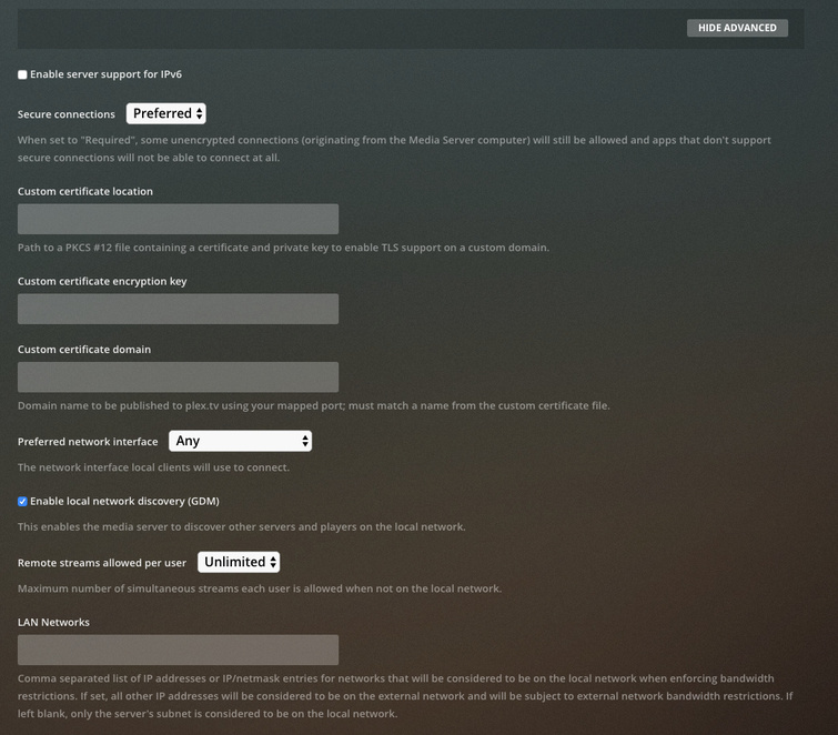

Can you check if IPv6 is enabled in network settings? I have seen some reports of this causing issues with metadata retrieval.
thanks for your reply. IPv6 is not enabled.
