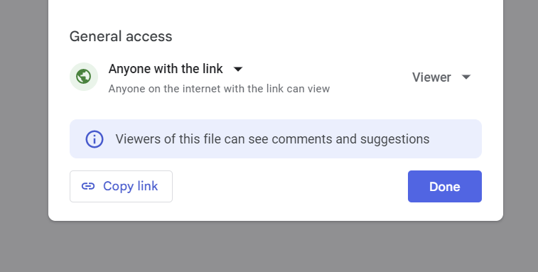

Unable to access. When sharing in Google Drive, please select this type of link
and please make sure you have included the details of the issue as outlined in my earlier post: lineup / zip / channel number / channel name / time of the tune and time of the issue and what the issue was
@sa2000 I was afraid of that, sorry, I have updated the permissions on the link.
