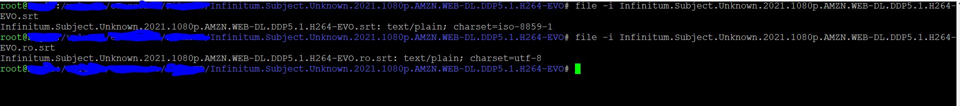

Hello Otto. I add you a sample where these kind of diacritics are not shown and file is UTF8
srt sample.zip (10.3 KB)
in this case is a synology server
There’s another older thread about this issue - you might want to jump on it: Plex Media Server doesn't recognize the language code for external subtitles
Looks like converting the file helps (there’s some notes in that thread about it) but also that this might be a regression…
Could you tell me if your screen shots are showing the correct letters or wrong ones? I am in no way familiar with Romanian, to be able to tell.
Your sample file is not UTF-8 encoded. It uses Western European Windows codepage 1252.

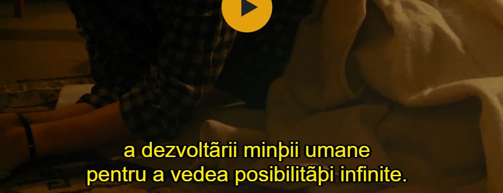

This is ISO 1252 western european (wrong character = þ this is not romanian character)
52
01:13:40,015 → 01:13:44,848
a dezvoltãrii minþii umane
pentru a vedea posibilitãþi infinite.
354

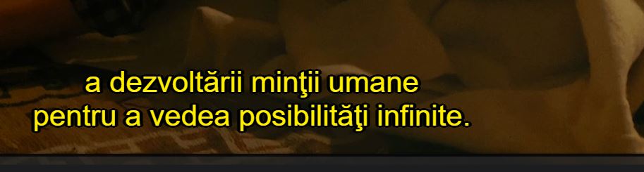

This is looking correctly, right?
I just tried your modified attached srt and is working correctly!! And yes your above printscreen is showing the characters in the right way

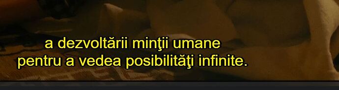

showing correct after conversion

I have to continue this topic. I played a bit with uconv
I took the original file Infinitum.Subject.Unknown.2021.1080p.AMZN.WEB-DL.DDP5.1.H264-EVO.srt (which is iso-8859-1) and convert it to utf8 (new file called Infinitum.Subject.Unknown.2021.1080p.AMZN.WEB-DL.DDP5.1.H264-EVO.rou.srt)
uconv -f iso-8859-1 -t utf8 -o Infinitum.Subject.Unknown.2021.1080p.AMZN.WEB-DL.DDP5.1.H264-EVO.rou.srt Infinitum.Subject.Unknown.2021.1080p.AMZN.WEB-DL.DDP5.1.H264-EVO.srt
Now in Linux the output of file - i is like this
In Plex with the new UTF8 file…shows wrong characters
In the end my point is that this should be manage inside Plex. A low or average user will no be able to deal with these conversions
adding the files
Downloads.zip (20.9 KB)
The file is not using iso-8859-1. It uses Windows CP 1250.
There is a difference between these. They are not synonymous.
could be. but this is the Linux output of file-i
and the file showed as UTF8 is having wrong characters in subtitle
You converted it from the other file, but by telling it that the source file is iso-8859-1, instead of Windows CP 1250.
Of course it shows wrong characters then.
yes you are right I did again the conversion using this time cp1250 to utf8 and is working
but what is strange is that linux see original file as iso-8859-1 and this is why initially I did the conversion iso-8859-1 to utf8
