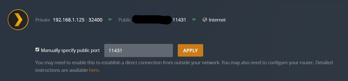

Anyway, I tried all that when the issue started. Until the issue started, I did not have any thing in the port forwarding for Plex. Even a few years back before I upgraded the router. I have rebooted, and reset, we even have had power outage after one of the big windstorms, so everything was powered off for 12hrs…
Again, the thing that makes me think it is something on the PLEX side of the internet is that right now, by using a custom port the only thing that does not work is the PLEX “redirect” back to my server. I assume it looks up my account info and magically knows how to find my server from some sort of DNS like data base, that seems to be broken.

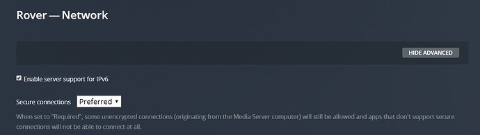

Do you have the server requiring secure connection ?
Do you have the apps set to allow “insecure on LAN” ?
You know you can make exceptions for any LAN or WAN IP in Settings - Server - Network ?

During the troubleshooting of all my devices suddenly complaining about secure connections, I changed the secure connection setting to “disabled” as that seemed to help.

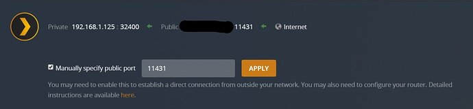

Then sometime later my wife tried to access //plex.tv/web from her desktop and it fail as describe above. So, I checked the remote access, and it was acting up. I had not noticed this because we haven’t left the house in 2 years thanks to the pandemic. So, I don’t know how long it had been broken. That is when I found that I had to do the manual port forwarding to get a solid remote access connection. But even though I could connect remotely using my public IP and custom port the “plex.tv.web” redirect still would not work. And that led us here.
So, while the UP&P on port 32400 still does not work, I can get the PLEX redirect to work by putting the secure connection setting back to “preferred” and my devices still can connect.
Also, because we recently had a power outage that lasted longer than Comcast batteries and I have a generator, I made the change to the settings so I can use PLEX on my LAN when the internet is down.
