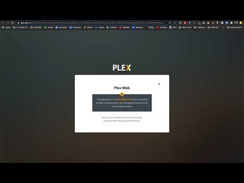

I recorded my screen to show you exaclty what I did.
PMS was still running so I have follow your instructions and upload new logs.
My NAS is in France so I’m connected throw a VPN connection to the router of my NAS from Japan. I’m connected directly to the local network of the router. Subnet mask is 255.255.255.0 on my NAS. Does that answer your question?
Logs.zip (1.2 MB)
