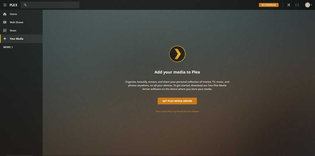

Hey guys! I clean installed my Plex Media Server 10 times and it still does not work.
please explain to me exactly how I should remove everything and then install, because everytime i try to setup my plex server in the web setup, it doesnt work. It either tells me “no soup for you” or it just puts me on this site:
I really need some help here

Hi guys, I managed to solve this issue. I have a plex running on a remote debian server.
First, I did a clean reinstall of Plex Media Server. When going to the plex website, it wouldn’t even display the setup process. So I opened a browser remotely by SSH, and went to localhost:32400/web and now I got it to work and could perform a new plex install!
If you have plex running on your computer directly, simply go to localhost:32400/web on your browser and it should work, I hope!
