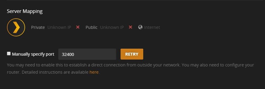

Not available outside your network Your server is signed in to Plex, but is not reachable
OS: Windows 10 Home
Plex Server: 1.2.2.2857-d34b464
Firewall: None
Antivirus: None
Security Software: None
UPnP: Enabled
Issue: Unable to successfully enable remote access.
Any help would be greatly appreciated. Thank you!

I’m having the same issue. It can see my external and internal ips but it has a red x for internet. Sometimes if I don’t manually put in the port it will work but if I try to access it, it is an indirect connection.

I have a red x next to public and private and nothing next to internet

Tried both, with and without it checked, same results.
