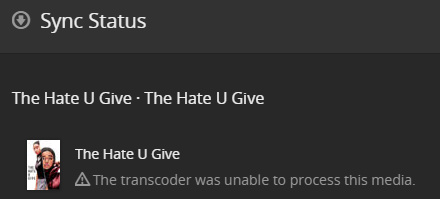

When I select a few movies and click on sync, some work fine and majority do not sync. All the app says there is an error with this item.

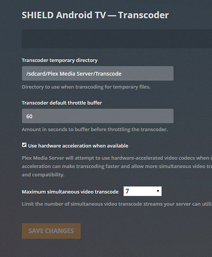

I don’t think it’s set by default. You have to create a folder for the Transcode to take place. Create a folder where you want the transcode to take place. Go to Settings, then Transcoder, Transcoder Temporary Directory and set the location, then Save.
Thx. I went to SDCARD and created a folder and pointed it there.
Im still having transcoder fails when trying to sync.
Is there something else I need to change to make it work?
The metadata and database are by default on the internal 16 GB internal storage. If your 128 GB is setup as Adopted Storage, then the metadata, database and transcode should be placed there vs the 500 GB drive. Also drop the name Transcode from the Transcode directory. For example mine is located /storage/emulated/0/Temp.
