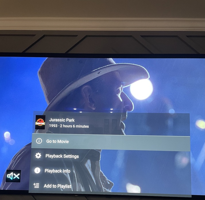

Thanks Chuck, however I’m not seeing the option to enable this on the Shield. Here is what I’m seeing.
I also do not see this behavior even with nerd settings enabled on my client.
