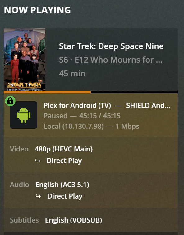

This morning I left it there and checked the dashboard on my computer and it looks like the “up next” episode from that postplay screen was registering as paused at the end of it’s duration. However, this episode was not played on the client yet according the post play screen on the client.
Here is a screenshot of the dashboard detail:
Event occurred between 1am and 9am. No other media was played after the event. Logs were generated around 9:05am.

Yeah, I only mentioned the paused state being reported on the dashboard because it was reporting that an episode was paused at the end of its duration but that episode had not actually played on the client.
Seems to be a disconnect between what the client is doing and what the server is reporting.
Not sure if it is related, either, but I try to provide all the data I can.

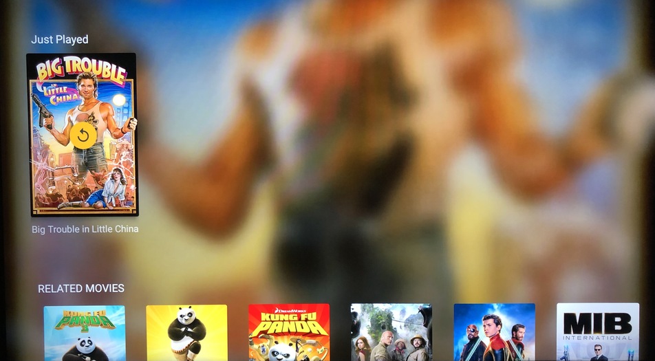

For expediency, this time I started a movie and used the chapter selection to fast forward to the credits. I let the movie finish and waited to see if the screensaver would start after its 5 minute timer. It did not. Client was still sitting at the “Just Played” screen:
I checked the PLEX dashboard again and it was not reporting anything playing this time, so that might not be related, after all.
