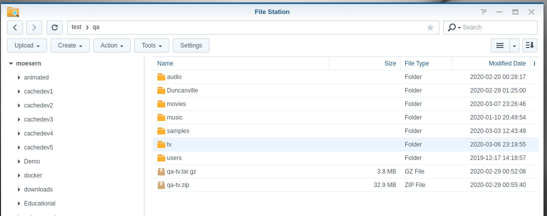

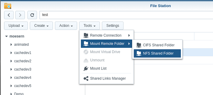

Synology does this easily in File Station.
Screenshot from 2020-03-13 08-30-36
Screenshot from 2020-03-13 08-34-16
Thank you so much! :slight_smile: So it seems im good to go for using Synology as a “Hub” for my NAS
Are there any differences in CIFS and NFS? When restarting etc? I currently have some USB drives connected to the buffalo and they cant be made into NFS only the internal drives. Though its not a HUGE problem because one of the reasons for a new NAS would be to get rid of the USB drives :slight_smile:
Depending on the Synology model, you can have up to 4 USB 3.0 devices plugged-in. This is an option for aiding transfer.
Synology does offer CIFS as well. I use NFS in a Linux-Linux environment because of the performance. CIFS is slower (the CIFS server & clients are not the newer, faster, versions)

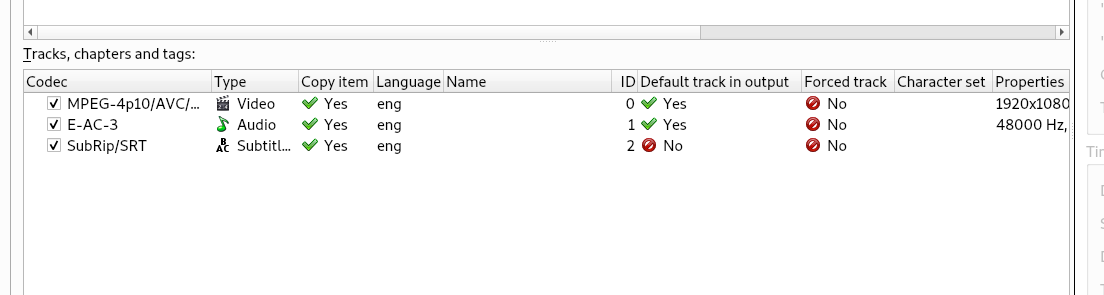

Here’s a quick look at what I can see about a video file.
This is one I’ve already processed.
