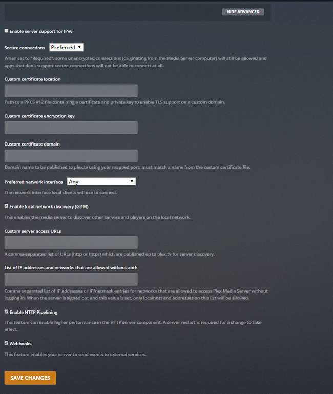

When I go to Settings - Server - Network - ‘Show Advanced’ , I do not see the option ‘Treat WAN IP As LAN Bandwidth’ on my Plex.
This is all i see:
