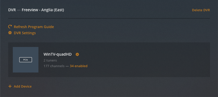

I’m only seeing the first two of the four tuners on this card when I ask Plex to detect it. I’ve seen screenshots of this card appearing as two devices, but I’m only seeing one. Happy to supply more information on request if anyone has pointers.

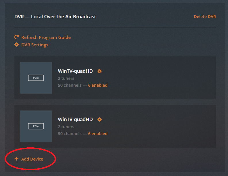

I am using the quadhv tuner card on Ubuntu Server 16.04.3 too with the 4.4.0-98-generic kernel. To get the second pair of tuners to show up, I had to click “+ Add Device”
Thanks for further suggestions - I’ve tried the patched 4.10 and 4.13 kernels but no joy, and clicking"Add device" again produces nothing.
