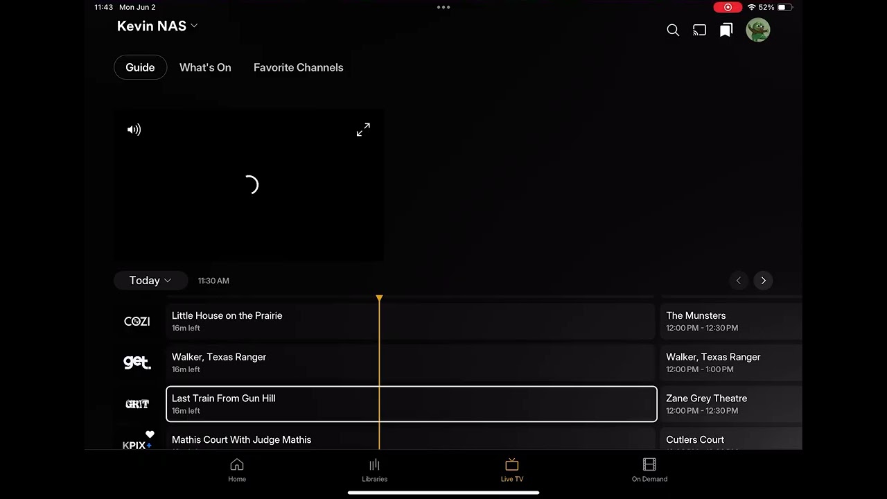

OTA Live TV has never worked on the new mobile app for me. There are many threads on it and Plex seems to be silent on it. Please update us on what you need to troubleshoot/fix this problem from your community or tell us something.
Video of the problem:
Logs from mobile and server:

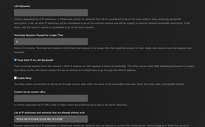

Only looking at your logs it seems like the app is not able to connect to your server address.
What is your network setup for your server? (if it isn’t the default)

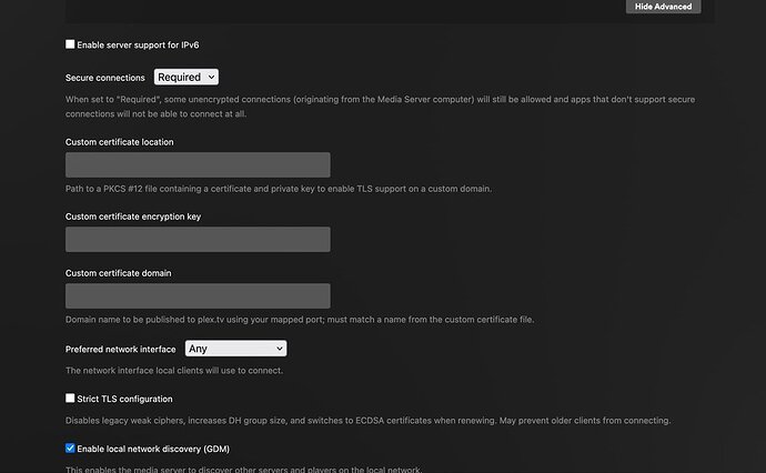

Same result when “Secure Connections” is set to required or preferred. Also should note that Preview Experience tvOS 2025.17.0 live tv works, but transcodes.

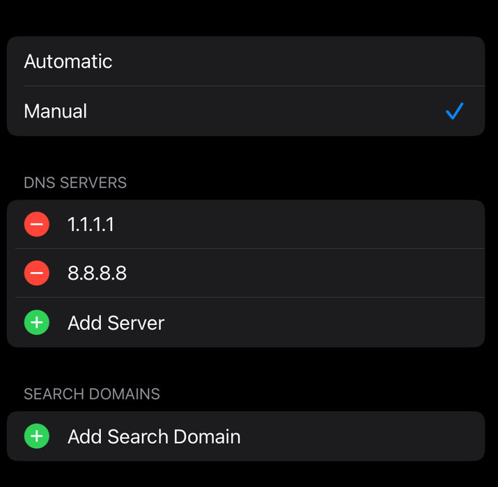

It’s a DNS issue, I just remembered that I had set my Apple TV to 1.1.1.1 bypassing the pihole. I just did the same on my ipad and it is now streaming transcoded.
What do I need to whitelist to fix this? I’m not seeing any blocked addresses when looking at pihole and triggering live tv. Problem is present even when I disable blocking in the pihole, and only goes away when I switch the DNS server.
I know just enough Unix to be dangerous. If you send explicit instructions on how to change the DNS setting I’ll give it a try. Happy to help with troubleshooting.
No unix needed. On your iOS device, go to Settings > Wifi > Click the blue i next to your wifi ssid and scroll down to configure dns click manual and make it look like this.
Then back out, relaunch Plex and check live TV. If you want to change it back again, you can just click automatic and it will go back to your previous settings.

Manually setting the DNS servers as you described above solved one problem. When connected to wifi at home on the same network as the Plex Server, I no longer get the Network error message. Most channels play normally (audio and video). However, a few channels (I think maybe just the HD shows) just display a black screen, even after waiting for more than a minute. I CAN play the same channels if I connect via cellular, although those channels take about 25 seconds to start playing. Let me know if there are other settings I can play with to help ID this second issue. and THANKS!!!
