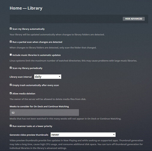

I think I’m having a similar problem. Running Version 1.14.1.5488. I have just over 7500 movies and 440 television series. When I move over a show or movie from my download directory, it can take anywhere from 30 minutes to several hours to scan and show the new content. I have partial scanning enabled, and everything is in a “movie” or “television” directory on a series of 8TB WD hard drives.
However, if I exit Plex in the taskbar then restart it, it picks up everything in under a minute. What can I change that will make this happen without having to constantly stop and start Plex? Thanks.

Yes, the directory are a SMB mount (Synology NAS). So I don’t expect the auto scan on changes to work. However the partial scan should.
No. it won’t. ‘Automatic’ is based on the Linux iNotify kernel service.
INotify only monitors locally mounted physical filesystems.
As I stated above, Windows emulates this by polling (reading all the directories) frequently.
So what you are saying is that the "Run a partial scan when changes are detected" setting is a sub-setting to the "Scan my library automatically" above it? If this is the case, I have misunderstood it. I was expecting this to run a partial scan during normal scans as well.
Correct.
PMS can either scan the entire library if anything changes or only those diretor(ies) which did change.

Okay. Too bad it cannot do the same without iNotify/Auto. You still have the folder modification times on a SMB share. This would have saved a lot of time scanning.
