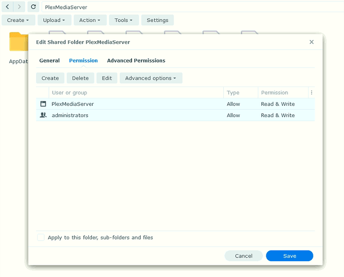

Open File Station on the NAS and right click on the PlexMediaServer folder and select Properties.
Then on the Permission tab, click to highlight PlexMediaServer and then click on Edit.
Make sure ALL Permission are selected and click on Done.
Then you MUST enable Apply to this folder, sub-folders and files and then click on Save.
That will then apply the correct permissions to all folders/files within the PlexMediaServer folder. It will take some time to complete, so be patient.

I’ve check permissions for this folder, and by default it was set to Read & Write
So i’ve changed them to full control
