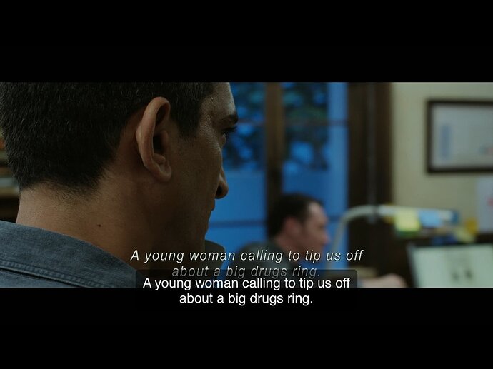

I noticed that after upgrading to the new iOS app, PGS subtitles no longer are working. Other types (ASS, SRT tested so far) work just fine, but PGS are showing in the middle of the screen and only showing partial subtitles (every other line, partial lines, etc). This is not the case with the web player–the subtitles work perfectly still. They were also working before upgrading to the new iOS app. I wanted to report this as a bug so it can hopefully be addressed in the future. Thanks!
iPadOS 17.7.2 (my iPad is too old for 18)
This screenshot shows both the burned subs I have in this version of the video and the external SRT subtitles file.

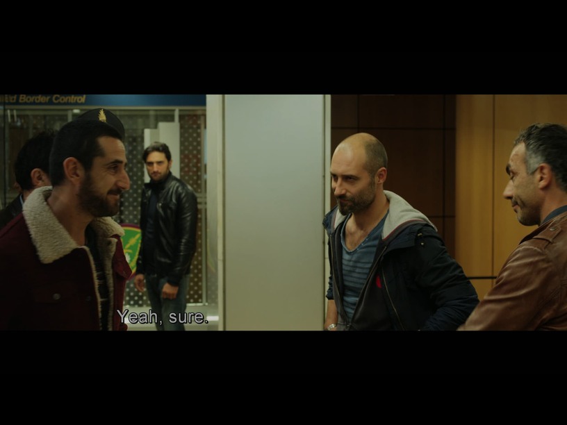

I tested both display and timing in 2025.12.1 (latest) and 2025.10.1
Both play identically and correctly for me on iPad
