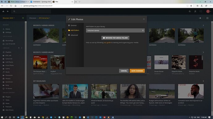

Dear all,
I have a Synology NAS with Plex on it.
I have created librairies for movies, tv series, music with no problem.
Everything is working fine.
When I create a new library for my photos pointing to the directory where they are on my server, I have always a message saying “There are no items in this library”.
Of course the folder containing the photos is shared as the others.
Any idea ?
Thanks in advance for your valuable help.

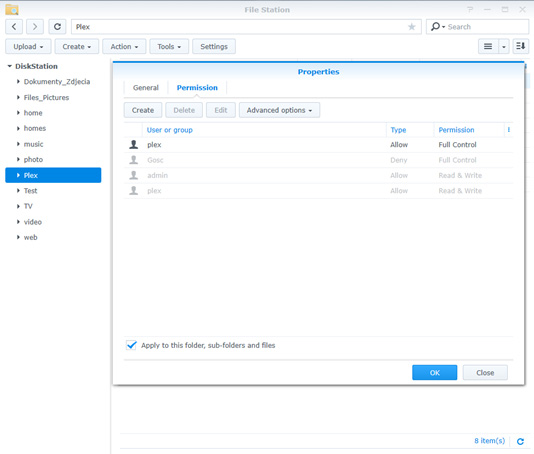

See attached files with the snap shot of my settings – I don’t see any problems with it.
It looks like FreddyBee and beckfield figure it out on this post what needs to be done (manual permission change), however I don’t know how to do it.!
pic1|690x529
Could you help me with it please. I’d very much appreciate it. It is anything else that I can support you with? (like my plex log, etc.)
Thank you!
I agree. Somehow the manual permissions set on the file need correcting.
I’m sorry if I missed that.
When you apply the permissions. please remember to “apply to this folder, subfolders, and files”.

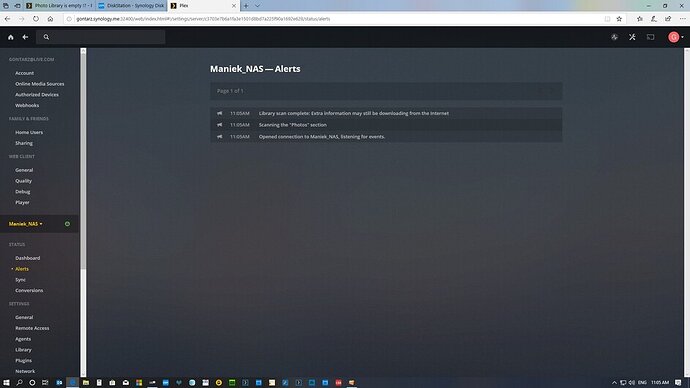

Answering your questions - I have no USB plugged external drives, all hard drives are internal and included in my synology unit. Second one - you are correct - the scan is very quick - see attached picture with the notes right after the quick scan.
