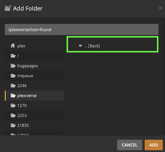

Make sure you’re scrolling all the way to the top after you’ve selected the PHOTOS share. If this is showing nothing but an option to go back (<- ..[Back]) while there are actually subfolders available, this is indeed a permission problem. You probably can verify the folder permissions on the level below the share itself.
