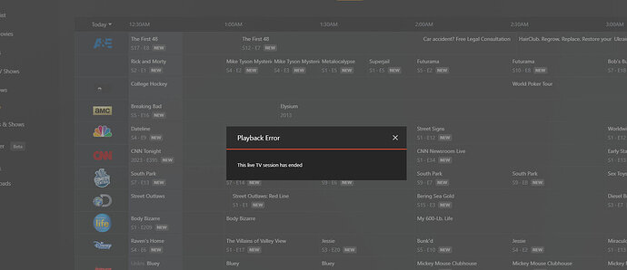

Playback Error: This live TV session has ended
Server Version#: 1.30.1.6562
Player Version#: 1.61.1.3432
Tuner Make/Model: xTeVe
Guide/Lineup name:
Using XMLTV?: Yes
Channel number/Name: All
I’m having an issue when anytime that I try to watch live TV from my Plex Sever, it gives me a “Playback Error” and says that the Live TV Session has ended. I am using Xteve with EPG best. It works fine if I use it through a web browser, through the IOS app, or on xbox. It seems to be specifically if I use either the windows application or Plex HTPC application. It’s only Live TV that has this issue, movies/tv shows are fine.
I just built this Live TV setup. Before, I used a HDHR hooked to an antenna in my attic and all the apps worked just fine. Any ideas?
