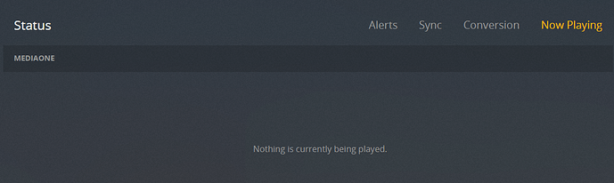

In need of some help, I am at a total loss on this. I am running Plex Version 1.8.4.4249. My system has two tuners in it, both on the approved list. One WinTVQuad PCI and one HDHomeRun Connect. Often times, I am getting the error show below. I have tried isolating the issue by removing overlapping channels from the lineup. IE: if the WinTVQuad has channel 4.1 enabled, it is not enabled on the HDHomerun Connect. Regardless of what I change, this error keeps popping up and it happens across ALL channels at different times. It is also causing the DVR to NOT record shows.
During these times NO other tuners are in use. Its like the system thinks all its tuners are busy.
I would REALLY like this to work…
