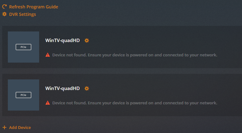

I am having this problem as well with the Hauppauge WinTV-quadHD tuner. It seems to be intermittent. If I try over and over, it eventually connects to the station. I have verified my signal strength which is good. This is a relatively new problem. I have tried removing and reinstalling these tuners from plex and windows where my server is running. I am running plex version 1.9.6.4385 .

My playback and tuner claiming/releasing has improved significantly in later releases (1.9.7+) - I Have not seen it erroneously claim tuners in use when they are not. I have seen it say “device not found” which was a first though it did not seem to impact live or recorded TV.
