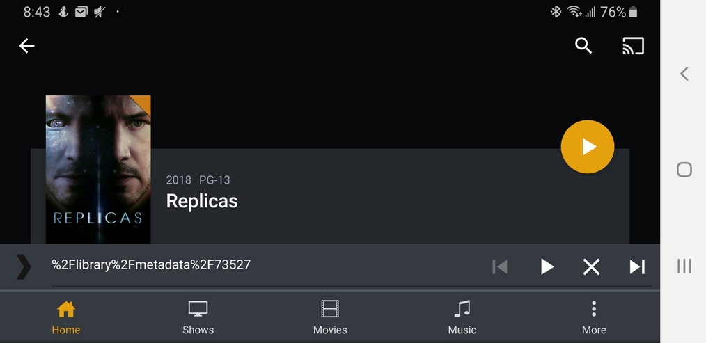

Playback error
This happens on all playback devices. Identical error. Doesn’t matter what movie or library. It’s exactly the same error.
Just used switch users and it worked with another user in the house. Appears to be just the admin account that can’t watch movies. Anyone know how to resolve this?

This seems to have to do with the pre-roll. If i skip the pre roll by pressing Forward before it can load, the movie will launch.
But yes, the non beta works fine.
yep just tested. newest beta doesnt work with pre roll. remove it and trailers/movies will work fine.

That only works on windows. I solved the issue by removing the preroll url. Everything else is fine.

Remove your preroll and you’ll be fine.
i have, but i figured they would have fixed said feature by now as its a feature i like to use.
Buuuuuuuuuuut this is all largely irrelevant as it seems they switched up the way the file is found, and simply didnt tell anyone. Much less post in any of these threads.
our $ doesnt pay for support i guess. Even on the forum level ;p
salt aside - people had a hard time w/ preroll initially as it needed the url from the web client and it was assumed it needed the actual path.
now they changed it to work like people assumed it did in the past. So you can use pre-roll, you just have to put in the path to the video as opposed to the url from the browser in laymans terms.
