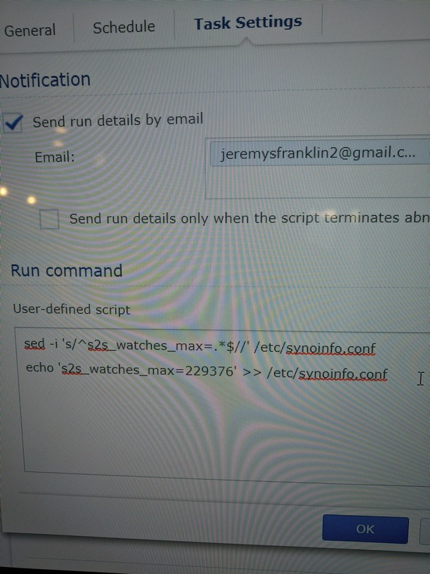

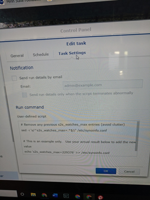

Show me what you have in the scripting please?
i wasn’t sure if it mattered to include the text in the command, but maybe it does
i didn’t know if it mattered if i had the text in the command post, but maybe it does? should i take out the text? do i need both commands?
thanks
i’m not sure how the scripts are supposed to look exactly. the examples have spaces in them?
I know it’s tough from the screenshots.
That’s why I included the pasted text.
so did my commands look correct? or should they look like this. i’m confused, sorry
i saw your pasted text (those were awesome), and i just copied them in, and just changed the number, then hit ok, then clicked on it so it turned grey and then hit “run.” but i didn’t know if i should remove the sentences that are before the commands, like it looks in the picture i attached. please advise :slight_smile:
i ran it like the picture above and then restarted the nas, and it still didn’t work, maybe i didn’t run the user defined script correctly

Remove any previous s2s_watches_max entries (avoid clutter)
sed -i ‘s/^s2s_watches_max=.*$//’ /etc/synoinfo.conf
This is an example only. Use your actual result below to add the new value
echo ‘s2s_watches_max=229376’ >> /etc/synoinfo.conf
this is what i pasted into the run command box. i then hit ok. then i clicked on that command (third one down) and it turned grey. and then i clicked run, it confirmed i wanted to run it, then hit yes. not much happened. the white control panel window that was open, briefly flashed, that was it. i also clicked the box to “send run details by email” but i never got an email.
i left the user as root
there also spaces in command script, not sure if that makes a difference
ok, i checked the email notifications- it wasn’t sending the test email. i logged out and logged back in again, and now i’m receiving the test email, i’ll run the scripts again and see what the email says
