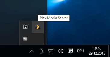

After starting the server, can you see a Plex icon in your task tray area?
And if you do, does it stay there when you place your mouse pointer over it?
PMS_tray_icon_win10
