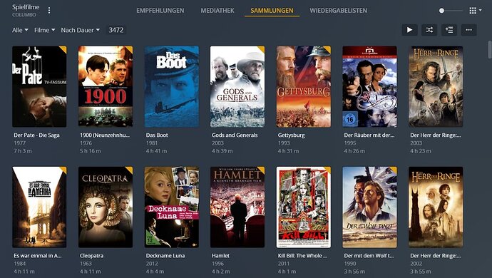

Here’s the library with its medathek view:
Notice the top ribbon… mediathek view is active.
Now, let’s switch to the same library’s collection view by clicking “collection” in the top ribbon:
Please see the orange Collection tab is active - while the library can only be seen in mediathek view.
I have no way of going to that library’s collection view - including dozens of smart collections and hundreds of collections - all with individual posters, etc…
Changing the view or sorting in the mediathek tab DOES NOT chance the view or sorting the the same mediathek in its now wrongly displayed Collection tab,
Argh…
Yesterday, all was working well… now, the collection tab is not operating.

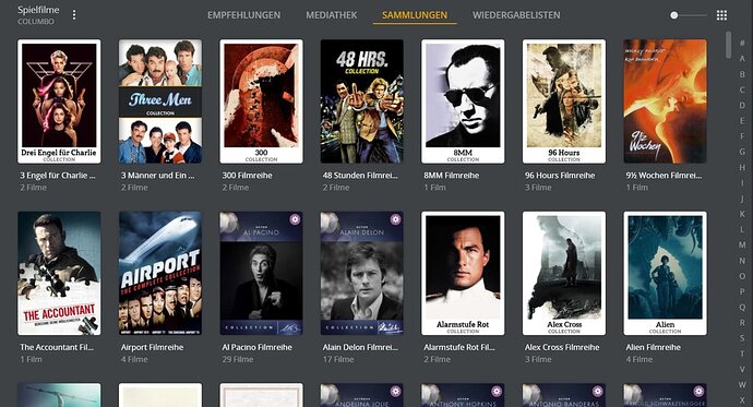

And here’s how it SHOULD LOOK LIKE:
