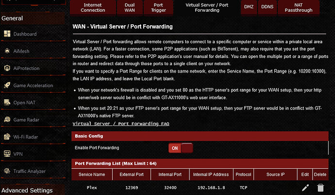

I have the AX11000 and have it working without issue. I am not by it at the moment to get my configs to compare though.
You need to go to WAN settings, then Port Forwarding.
Set your port forward there and use the port you’ve got configured vs the one I’ve manually configured:
