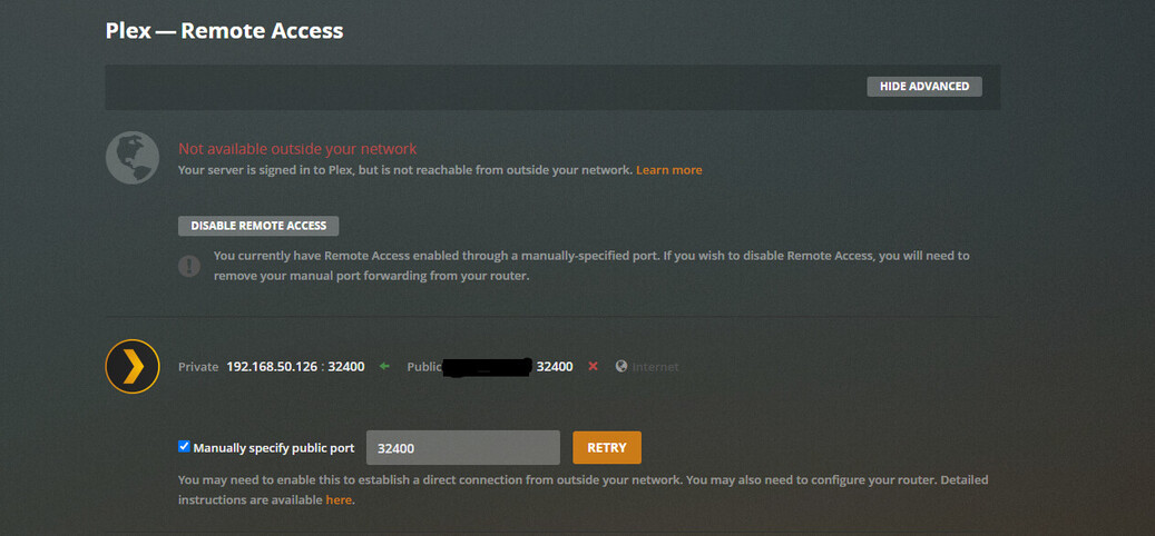

I have had my Plex server set up for 7 years in my old house. We recently moved and I needed to upgrade the wifi in the house. I went wifi 6 with the Asus GT-AX11000 for my needs. I don’t know what is happening but It will not allow my Plex server to connect. I have tried auto and Manual. I have the port number in the Router but it still wont work.
The server will say online, then 5 seconds later it switches to Not available outside your network. I was hoping someone with a Asus router has run into this issue and has a solution to it. I appreciate it in advance!

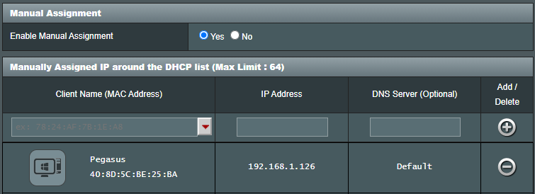

Did you assign the Plex Server a static IP address or reserve an address in the router?

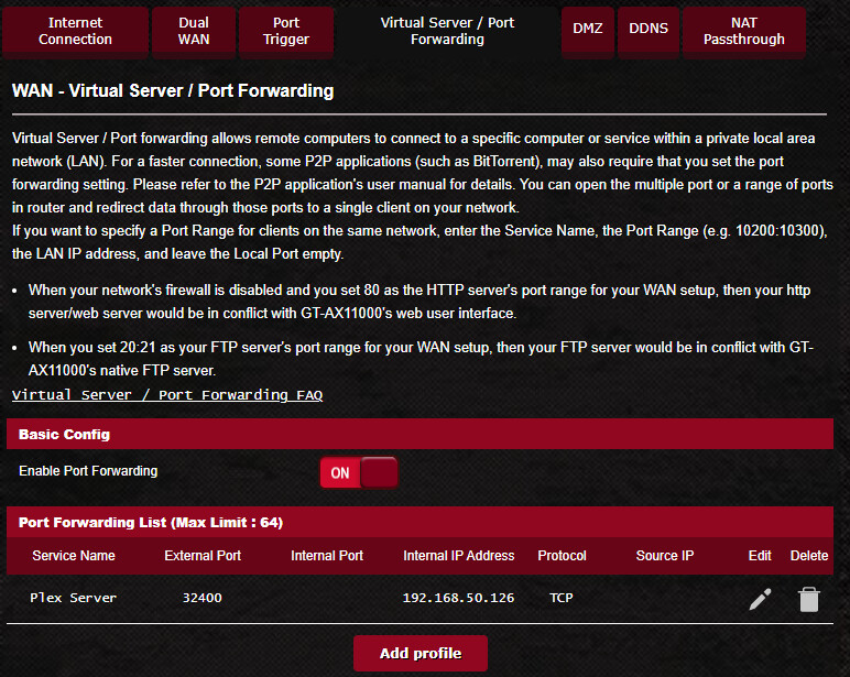

Please show a screenshot of the port forwarding rule in the router.
Please show a screenshot of the remote access page from your Plex server. Cover any public IP addresses. Do not cover any port numbers or local addresses (ex: 192.168…).

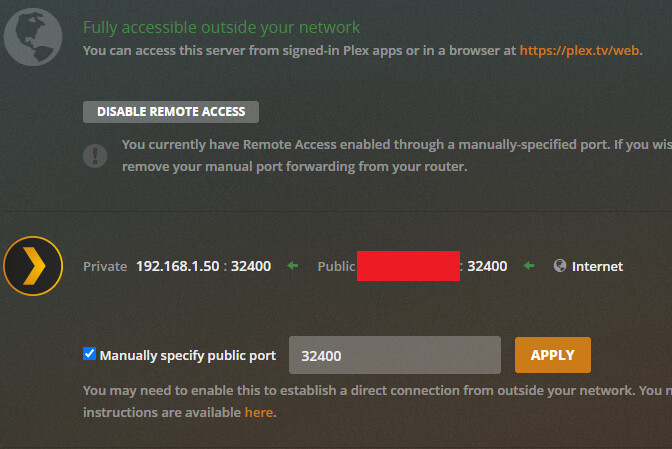

Additional Info: Troubleshooting Remote Access
Port Forwarding statement in Asus RT-AC68U (WAN -> Virtual Server/Port Forwarding)
Router Assigned IP Address example (not my Plex server) (LAN -> DHCP server)
Plex Server Remote Access settings. Notice address & port alignment with router port forwarding.
Screenshot (457)

In your port forwarding rule, add an internal port of 32400.
Then in Plex Remote Access, disable / re-enable remote access.
Same results.

It is possible for remote access to be working OK and the Plex status screen show it as unavailable.
You can check remote access via canyouseeme.org.
  • Go to the site using a browser on your Plex server (or any other system on your home network).
  • Replace the default port 80 with your remote access port, 32400.
  • Click Check Port.
The web site will try to reach your Plex server on the remote access port. You’ll see a “Success” message if things are working correctly.
I will attempt this when everyone is off work today. I will report back. As for checking the ports, the tool said it can NOT see an open port on 32400
