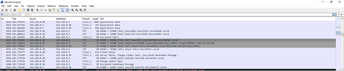

I sent by Email an set pf new logs include a record of all network traffic.
the gray network packets shots the client changes the TCP ports from 44982 to 44994 during buffering while client is busy on TCP traffic related to UPNP.

change of ports TCP streaming ports from : 192.168.0.30:44982 to 192.168.0.30:44994 when SRT subtitle are enabled.
it takes the client 2 min to close the OLD TCP port connection and open the NEW one.
when SRT subtitles is disabled no change of TCP streaming ports.

That’s normal. If the app is direct playing the subtitles and not needing to burn them in, they will request the file from PMS through a different port. This way it doesn’t affect the transfer of the video file.

I synced the time stamps of the network traffic recorded to the PMS logs around the 2 min buffering gap and it match , buffering end just after the close the **close the OLD TCP port 44982.
I am almost sure it is relayed to the issue.
