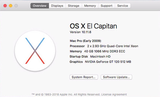

Plex Server config.
Screen Shot 2021-01-30 at 9.55.53 AM
Dont think many of the GT cards are compatible with Parsec. Need a GTX card from the looks of things. Not sure if the install version makes a difference either. Nvidia allows you to install either gaming or video configuration during driver install
