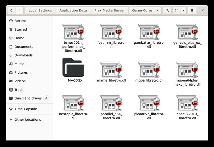

Please provide your xml and a screenshot of the core files.

Ah, those are windows dlls and you’re running on OSX.
You could look for the corresponding dylib files (which are the OSX equivalent files) but it’s generally just much easier to use core manager (I think there a stickied post for it) which handles the job of finding the right core, putting it in the right place and updating the xml file.
That’s actually Ubuntu (Linux) but it’s running the Windows version of Plex Media Server via Wine.
At first I thought that this was the issue so I tried the same cores on an actual Windows machine running Plex Media Server… still no go.
Apologies, I can see that now. I hadn’t realised just how close the UIs had become over the years (I’ve not run a windows manager on a *nix for a long time now).
