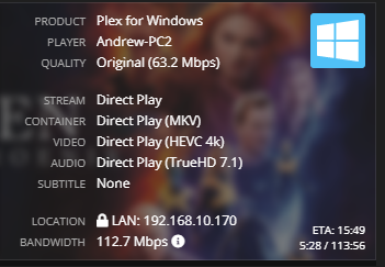

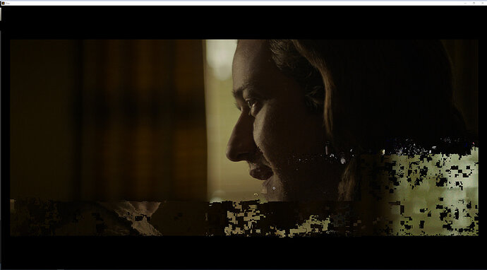

I have Plex server running on a dedicated windows box. I’ve noticed video artifacting/choppy playback to multiple clients while the server is direct streaming. I’ve noticed this with both the windows app and the Android TV app. Here’s what it looks like
I don’t notice this issue while transcodeing and I’ve seen it happen with 4k and 1080p content. The files play fine with mpv, vlc and kodi.

Just tossing out an random idea here, but I’ve seen this kind of thing when there is some kind of network/ethernet issue, and the artifacting happens when some packets didn’t make it. If you have a different switch, perhaps try swapping it out temporarily to see if it matters?
There are also a number of tweaks you can make to your ethernet adapter driver in Windows, but unfortunately I can’t seem to find that forum post right now.
This may have been the issue. I changed the switch and it looks like the issue went away. I’m still doing some testing.
