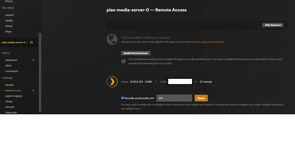

Also when I try the remote access it seems to be fine, but when I exit the settings page for remote access Im getting error again.
When I set it up its:
But then I exit the settings page, go to like Network, and suddenly it shows red exclamation mark
and when I go back its in this state
may the remote access cause the problems ? I dont think so because Im using my own DNS to access my instance of plex no?
(I’m assuming you blanked out your IP address and you are not seeing a white box there)
Since you mention custom DNS, does that mean you have set the Custom server access URLs (in the Network section of prefs)? If so, you need this to also resolve outside of your network to your public IP address as this is the address given to clients both inside and outside of your network.
