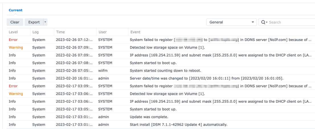

Woke up this morning to Plex not working unsure exactly what caused it, downloaded the logs, and found some issues where the db might have been locked, unsure if this is the root cause or not.

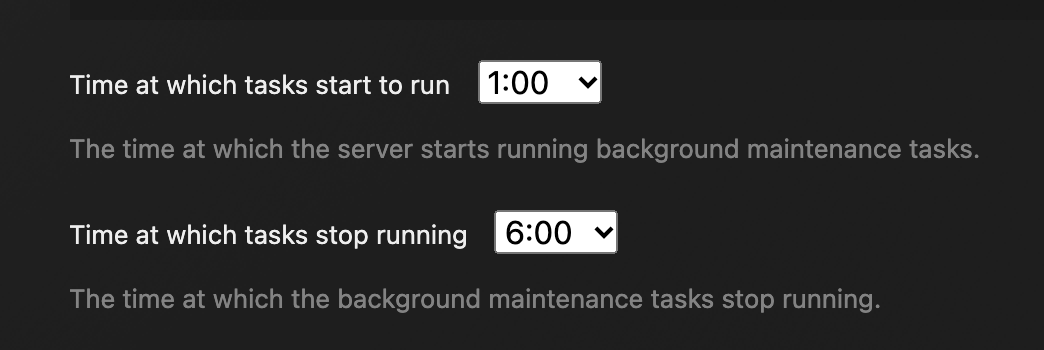

Plex is crashing during maintenance. I have observed this on all of my servers.

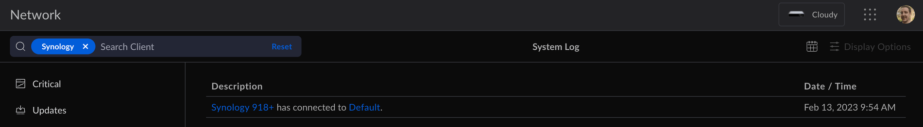

@wiifm
You have (first) a network issue.
It think it’s a Yo-Yo.

Checking Unifi client connections for the NAS (which would list event such as reconnections etc) only shows the last time I unplugged the NAS.
Checking DSM logs, I see the upgrade DSM on the 17th, and then my reboot to “fix” Plex at 7:05.
I suspect the logs you saw in Plex, are due to the DSM reboot 5 minutes prior. Plex was dead prior to the reboot.

I did notice in your log snippet above that an invalid IP address was assigned (169.254.211.59). That may be due to your use of NoIP though.
That may relate to the network errors that Chuck pointed out, but probably not related to the server crash.

I checked on the maintenance time
And it does fit within when I expect Plex actually crashed.
Yes, I also saw server crashes within the maintenance times, which is why I suspect you have a similar issue.
If you can disable Credit Detection for a day or two just to confirm it is the cause of the server crash or not, that would suffice.
