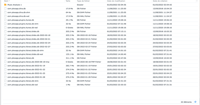

I found this files in the folder.
Which of these backups should I use? And which is the main one?

@ChuckPa please, can i have some help to find which of these backups I need to use? And which one is the main? How can I swap them?
@tholelosan
There is no “best method” for trial-and-error selection.
I prefer to go as far back in time as I can and then update that older one (which is painless)
The general procedure:
  1. Stop Plex
  2. remove the com.plexapp.plugins.library.db-wal and com.plexapp.plugins.library.db-shm if they still exist.
  3. rename com.plexapp.plugins.library.db. Add a -original to the end of the name
  4. copy the older backup and make its name com.plexapp.plugins.library.db
    – Copy the file to a different folder somewhere (some machines require this technique)
    – Rename it in that other folder
    – Move the renamed file back
  5. Start PMS
  6. Scan files & Refresh all metadata for each section
