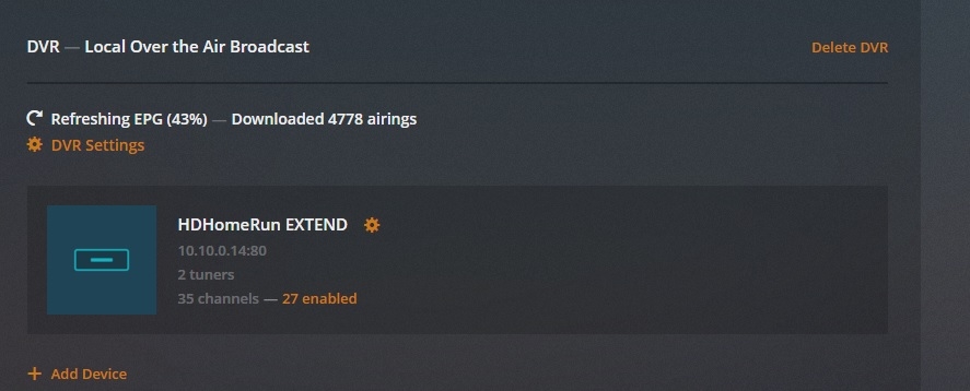

I have Version 1.6.1.3722 installed and an HDHomeRun Extend, which Plex does detect in the DVR settings. The Program Guide is empty and when I refresh the EPG it appears to download the data but at the end of the process there still isn’t a Program Guide and my recordings don’t download.
The Program Guide has been an issue for the past week and a half and prior to that loaded correctly.
Would love any tips, while there wouldn’t be any obvious changes I’m hoping there is some setting that I can tinker with.
Thanks!
