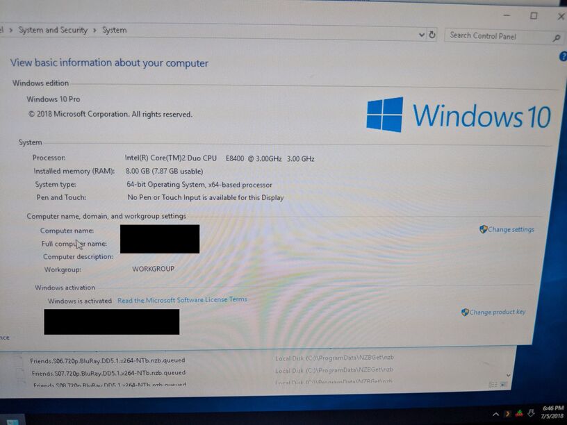

What platform is your server on?
It looks like an SD 4:3 channel stretched to 16:9 ratio. Can you verify the channel tuned to and the actual resolution of the source?
Hi, It’s a Windows 10 box.

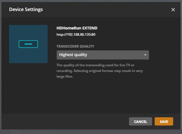

What do you have the Extend Transcode setting set to? Going to guess High Quality. From SiliconDust Support regarding the Extend High Quality setting.
It drops one of the fields and resizes to 1280x540 with a flag to decode as 16:9.
Guessing Plex is not using the flag to decode as 16:9 and giving the odd display.
Yes! That’s it! I had it on High Quality. Changed to Highest and it’s now playing full screen. Wow! Can’t believe it took this many months! Basically I need to use Highest or Medium I guess and not High. This is what I had

Changed to this
2
Thanks for the help!
High Quality is helpful when you have interlaced Live TV content and the Client device you are viewing on can’t handle Interlaced content. The High Quality setting forces the Extend to transcode to H264 and remove the interlaced frames. This then allows the Client to Direct Play the content. I have sent an internal message to one of the Transcoder Engineers with this thread so hopefully he can look at it and figure what needs to be done to display in 1080p. Instead of the 540p you were seeing.
That’s very helpful. Thanks again. I’ll probably try that setting again once and a while in the future to check if it’s fixed since I was happy with the quality. I don’t have a very powerful processor on my HTPC so I liked to offload some to the Extend.
