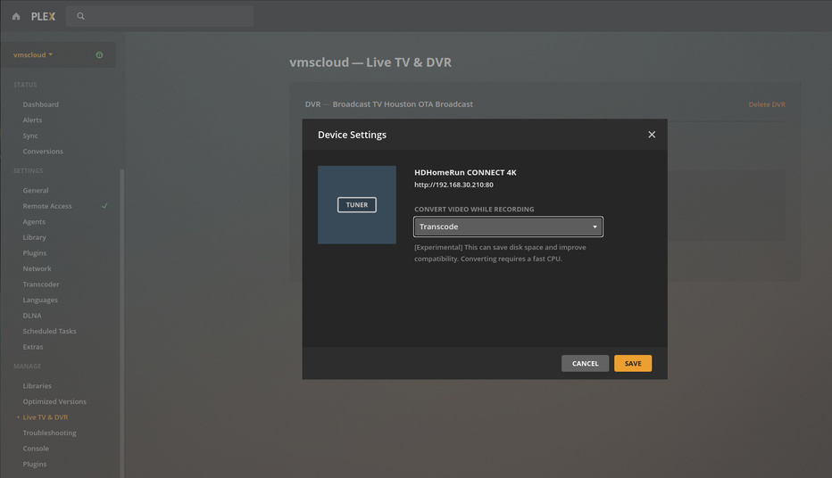

I had the same problem. I am using HDhomerun Extend and Fire Stick 4K., The live tv will go back to guide after 3 or 4 minutes. Problem is solved by changing the transcode setting,
Open Plex sever, manage, live tv & Dvr, device settings change the transcoder quality to original format from Highest quality. Save and wait for couple minutes. Start your plex app on FireTV. Check your playback information and make sure the source is direct.
Plex Server, manage, live TV & DVR, device settings does not have a transcoder quality. In that setting, I have only Transcode while recording on or off.

I had transcode turned on in HDHomeRun CONNECT settings and I turned it off a few days ago.

Setting “Transcode Interlaced Live TV” to off makes the video continue, but the audio is way off on my TV. The only thing that I watch live is sports, so this workaround is acceptable for me, but it probably isn’t for everyone.
