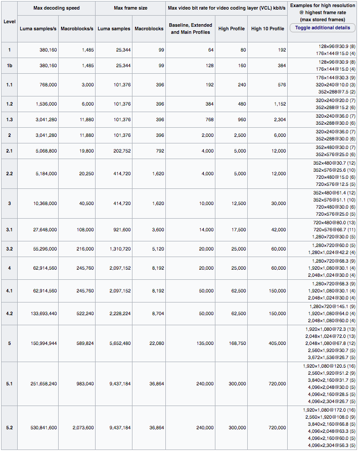

They seem to have the same H.264 specs based on the information listed for each device here -
https://developer.amazon.com/docs/fire-tv/device-specifications-fire-tv-stick.html?v=ftvstick4k
“H.264 . Hardware accelerated up to 1080p @ 30fps or 720p @ 60fps, 20 Mbps, High Profile up to Level 4”
No, as far as I understand it the recorded file isn’t transcoded (unless I configure it to?), Plex, or any other broadcast DVR, just dumps the transport stream onto disk as a .ts file . The .ts file being a container which contains files in the encoding format used by the broadcaster, in the case of the problem streams it being h.264 (level 4 in the file I’ve just looked at) @ 1080i resolution.
Lowering to 3.1 fixes live tv as it forces the server transcode, however, it seems to break audio on some of my files doing this. Audio (AAC) is streamed and video is transcoded.
