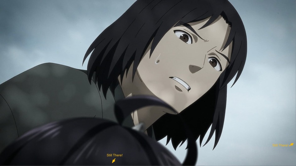

Right after my Mac client auto-updated to the new Plex 1.34.1 desktop app, whenever I play a video file there appear to be scrollbars appearing and disappearing on the right and bottom edge of the screen. They blink on and off faster than once a second, so it’s super distracting.
It stops when I pause, and they are only present during video playback.

Well, this is frustrating, I would say during the 1st few mins of any show/anime it’s non-visible however getting in 15+ min it’s very visible & the bottom bar decreases in size as you get closer to the end of an episode/film.
the lower resolution you play at the more visible those bars are. very frustrating when watching very very old shows.

Strangely, I’ve had intermittent cases of it appearing in fullscreen, then disappearing when the cursor does, then reappearing when ‘Skip Intro’ comes up where it then stays flashing. Have also changed the sys pref for scroll bar options thinking it could be related (they stop flashing, stay a solid bar, and grow in width when the cursor is over them, akin to scroll bars), but it made absolutely no difference… Haven’t had any differences with changing resolution, window size, monitor, etc. They also disappear when it is paused but will appear then fade once when the UI comes up with cursor movement and likewise when the UI goes with inactivity (the vertical line also reduces in height when the UI disappears, from full window height to about 7/8th). If any of that is at all useful or not…!
