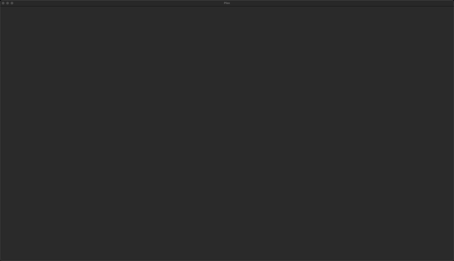

After auto-updating to latest version of Plex for Mac player, after launch I am getting stuck on a grey screen with no ability to do anything (see attached screen shot) after the Plex logo is displayed.
I’ve attempted to remove and re-install the app, but with no success. I tested on a secondary machine running same version and did not have the same issue. The only difference between the two is “Automatically sign in” was checked in settings (set to yes/true) on the computer presenting the issue - my gut tells me this has something to do with it, as I have seen this “glitch” before, but was always able to resolve by restarting. (The other machine I tested on which doesn’t present the issue requires selecting user account/entering pin)

Ditto. Uninstalled manually everything from the library related to Plex. Restarted. Installed fresh player 1.44.0.2981. Grey screen, cannot do anything. Preferences do not even appear. Random clicks don’t appear to do anything.
MacPro 6,1 with OS 10.14.6.
