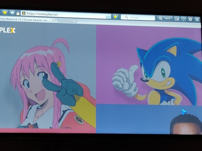

Hey @plex_tyrael_metaname_de I tried with webbrowser on my 32" model, I can browse to plex.tv, but there is just a background, no login screen or something else… So I am also impacted? See screenshot
i think you (or better yet: the H-Series) seems to be fine.
With the TLS 1.1 Problem you wouldn’t be able to visit the website at all.
So i think you are in the clear, i still need to fix it for myself and other people who have G-Series and lower.
