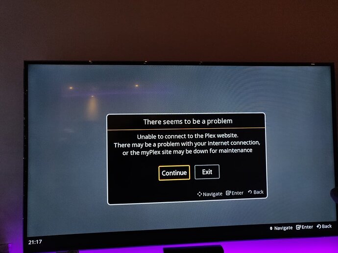

Ok, some more investigation, we can see in left low corner user status , since a few weeks it’s always offline, no idea why .. when I click the green button, to go to user settings, I get screen below, and the app crashes, and Plex is exited…

I’ve a JS 8500 model. I try to add a local PMS but I can not. I got this message and now im stuck with no app anymore
