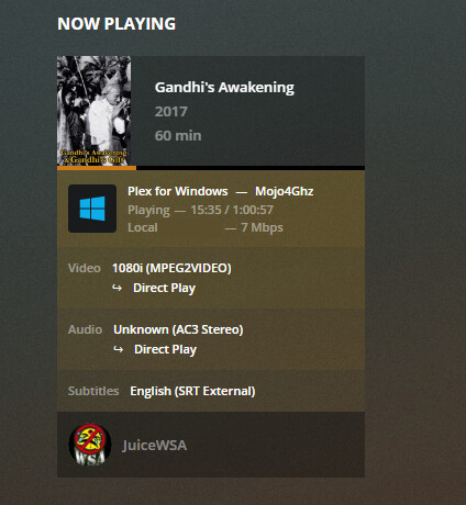

It should be Direct Playing that video - I just tried one of my own MPEG-2 Streams and all appears to be well with PfW:
If you have any problems, check the Dashboard Details and you may find it transcoding - depending on your server that might be the troublemaker.
