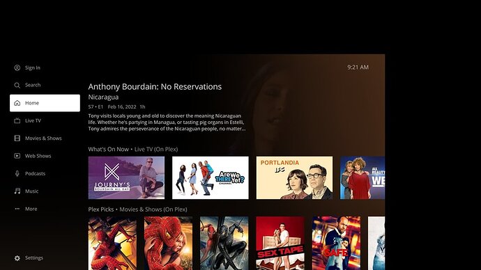

I get a “my-server-name is Currently Unavailable” message. Plex media player and web version work fine.
I tried to set manual connection IP but it still does not connect. I do have an internet connection in-app as the Plex movies work, just not my server.
I installed it via script in the first post.
OS: Manjaro GNOME x11
Logs: Plex HTPC.log (93.7 KB)
How do I install the linux version? I downloaded the snap, I created the install script and I tried running both
You just pass the file location of .snap file to the script. Ex. “sudo bash install.sh plex-htpc_1.11.0_amd64.snap”.
Note that you need to have “snapd” installed.
Thank you! :slight_smile: It worked

I presume you mean alpha-server? The logs only indicate that it failed to connect to the server after 8 seconds. Unfortunately it doesn’t contain much more.
Additionally, for Linux users we are asking for help in testing out EGL support. See this thread for details and please report there: Testing Linux EGL
Talking with one of the other devs, we have some more questions for you.
  1. Is their server local?
  2. Is it published to plex.tv (the server logged in and is telling plex.tv its IP addresses)?
  3. What IP address are you adding manually?
We did look at your account and it seems like you don’t have the server published on plex.tv which could be hindering discovery of the server.
Your suggestion was right. My Plex server was in some weird state. I could use it, change settings, it worked like normally connected to my account with all plex pass bonuses but when I went to check app.plex.tv it told me first that it can’t do a “secure connection” and then after a few retries, it gave me “Access denied”.
Apparently, it declaimed itself from my account. I generated a new claim token and used it to connect the server to my account again and now both app.plex.tv and HTPC work.
It’s weird cause I can remember it working not that long ago through app.plex.tv. And PMP worked without a problem.

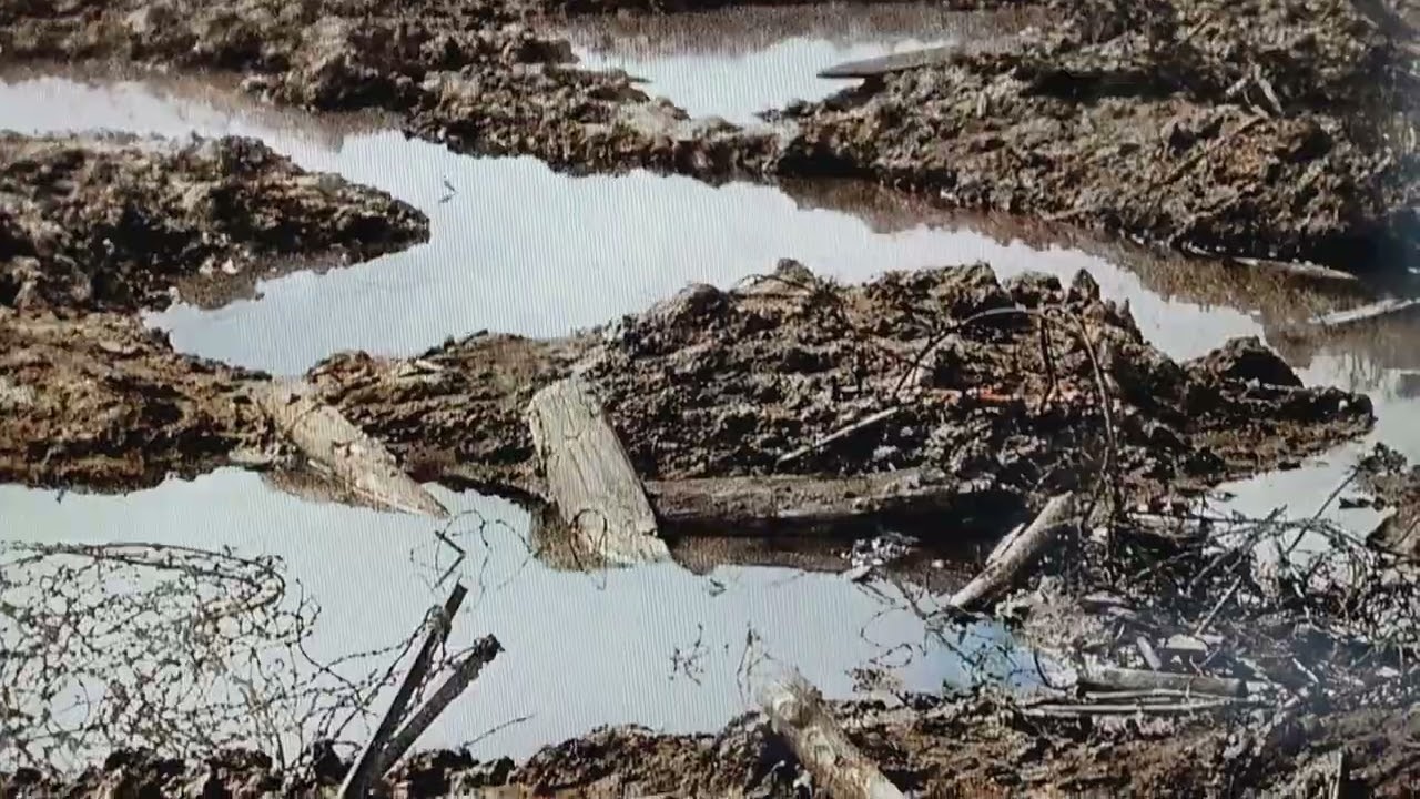

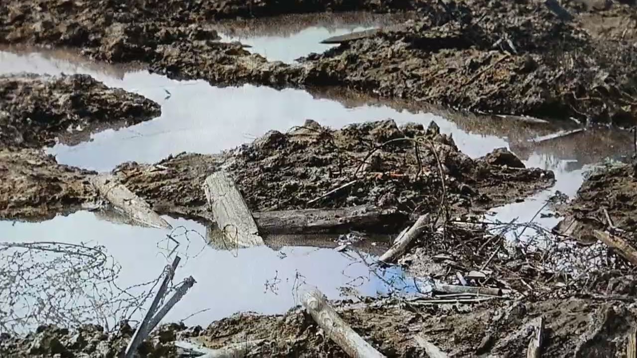

Thanks for the reply, here is the info. Let me know if I’ve missed something.
  • Intel I7 7700k / NVIDIA RTX 2070super
  • attached logs
    Plex HTPC.log (312.3 KB)
  • Maximum quality
  • Currently no mpv.conf configured
  • Appears to be normally smooth after a quick test with the latest MPV application without any extra config. Stuttering in HTPC is continuous with the example file.
Here is another log from yesterday where I played the file longer and I believe hardware decoding was enabled, same constant stuttering issue.
Plex HTPC.2.log (720.9 KB)
I did some further testing and the stuttering happens in both hardware and software decoding on my 60hz TV when set as primary display.
However if I change the primary display to my 144hz G-sync monitor and run it there, it doesn’t appear to have the stuttering.

It’s worth testing with the quality set to a lower quality for now. The options set in the quality setting are NOT set in the MPV application by default. Usually it’s the scaling which is the big factor but in this example you are playing 1080p content on a 1080p display so it may not be that.
There are no drop frames being reported and only ever one frame which didn’t flush on time. Usually any sort of stutter shows itself in these.
Additionally the standalone MPV will prefer d3d11 as the gpu-context (Check to make sure this is the case with your hardware by running mpv.com -v file from command prompt). So perhaps this will work better for you in a future version of HTPC.

I have set the video quality to low and experienced no difference.
I can confirm that MPV standalone picks d3d11:
[vo/gpu] Probing for best GPU context.
[vo/gpu/d3d11] Initializing GPU context ‘d3d11’
[vo/gpu/d3d11] Using Direct3D 11 feature level 12_1
[vo/gpu/d3d11] Device Name: NVIDIA GeForce RTX 2070
The G-sync monitor and the TV display both are changing to 24p when playing the file.
I have prepared a couple video clips to illustrate the difference:
Desktop Monitor set as primary display and changed to 24fps:
Motion is smooth as expected.
TV Monitor set as primary display and changed to 24fps:
Constant stuttering. (But no apparent dropped/mistimed frames like you saw in the log)
Let me know if you have any other suggestions.
