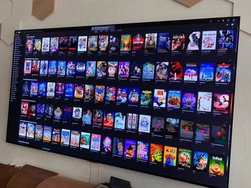

So, I managed to get it running with one problem left. The plex htpc Linux I downloaded from plex.tv doesn’t want to go into player kiosk mode. When I click on the full screen mode it just says in the wever interface.
