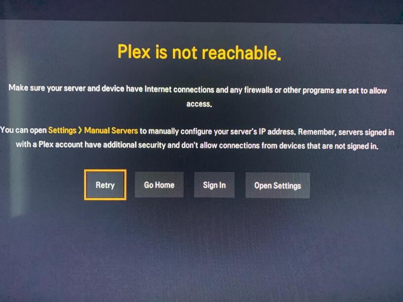

´´plex is not reachable´´ remove the application on a lg tv I reinstall and get that message, I am on the same network I configure the ip of my server and it does not work for me and when I close the application on the tv it does not save the changes, someone help me with this error thanks

Same here. It was all OK and all of a sudden, I get the “Plex is not reachable Error”.
Attached are the screen shots.

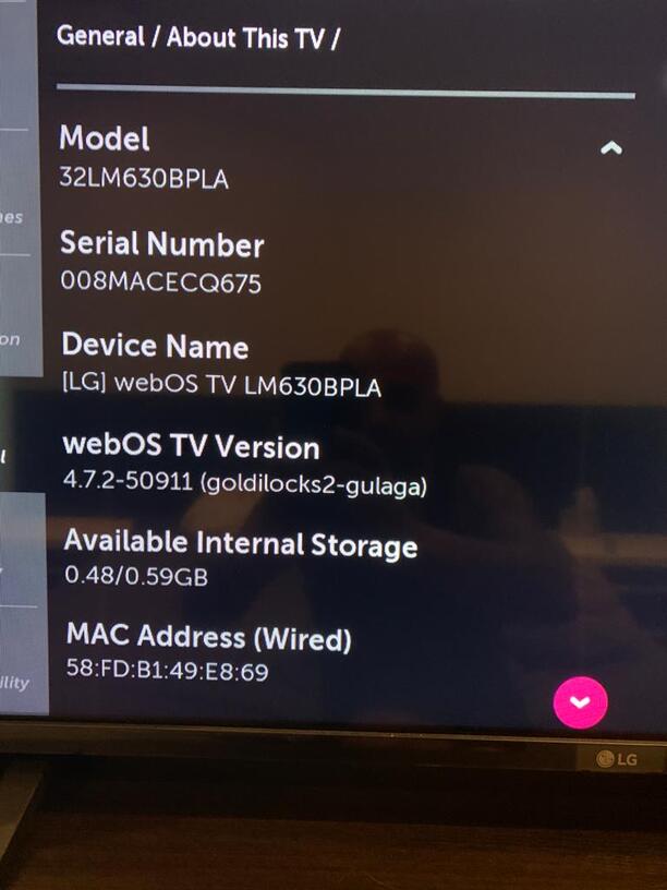

Plex for LG - v3.13.28
webOS - v4.7.0
Please, investigate the issue. There is obviously a problem with LG’s TVs.
SajOfTheSafirs: Your LG 32LM630BPLA is a 720p Smart TV.
plkocev: What is the model number of your TV, and is it HD or UHD?
If it’s 720p or 1080p (HD) then I am sorry to say that you are out of luck.
As it seems that Plex has now dropped support for non-UHD (4K) smart tv’s.
