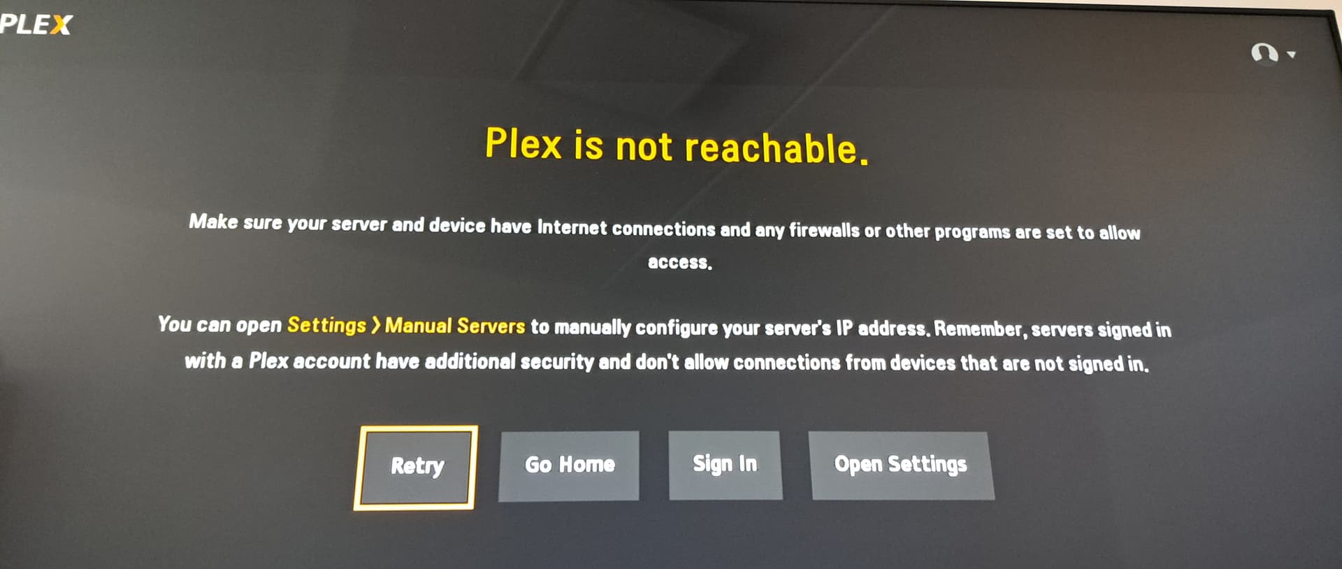

On August 29, 2024, Plex suddenly stopped working on my LG 55LA965V (2013 model). I was watching a movie, paused it for a while, and when I returned, it didn’t work.
The TV says:
“Plex is not reachable. Make sure your server and device have internet connections, and any firewalls or other programs are set to allow access.”
The problem is that it was working perfectly before. I run my Plex server on my Synology NAS, and I can access it from any other device (smartphone, tablet, computer), so it definitely has an internet connection. I can also access files from the TV via DLNA, so the TV apparently has an internet connection as well.
Do you have any suggestions on how to get it working again?
(Reinstalling Plex application on my LG TV was the first thing I did and it didn’t help.)
Thanks.

Note: Due to root certificate limitations with the device OS itself, only webOS 5.0+ devices support secure connections with a personal Plex Media Server. To allow connections to a personal server, devices running earlier webOS versions must be set to Allow Insecure Connections in the TV app settings and the Plex Media Server must be set to Preferred for the Secure Connections preference
I do have Plex Media Server set to Preferred. I’m having trouble saving the new settings on the TV. Whenever I exit the settings and come back, the default values are there.
Retry button just keeps returning me to the same screen, Go Home and Sign in buttons do not work at all.

Here are the screenshots:
The settings do not allow to save changes anywhere.
